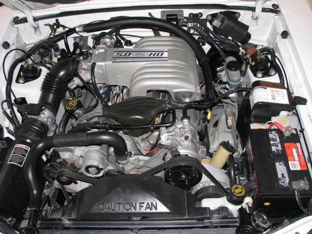

I've had the car for almost two years and never got around to taking any under hood pics. Here is the first. I've got two pretty glaring concourse errors. See if you can find them.
  • I would say the water pump bypass hose clamps are one problem, not being the spring-clamp style. If I remember correctly my 1990 7-Up show car had all spring-clamp style hose clamps on all of the under-hood front-of-engine hoses.
    I actually have some of the screw-type stainless steel adjustable hose clamps with Ford oval logos cast into the portion that holds the screws.
