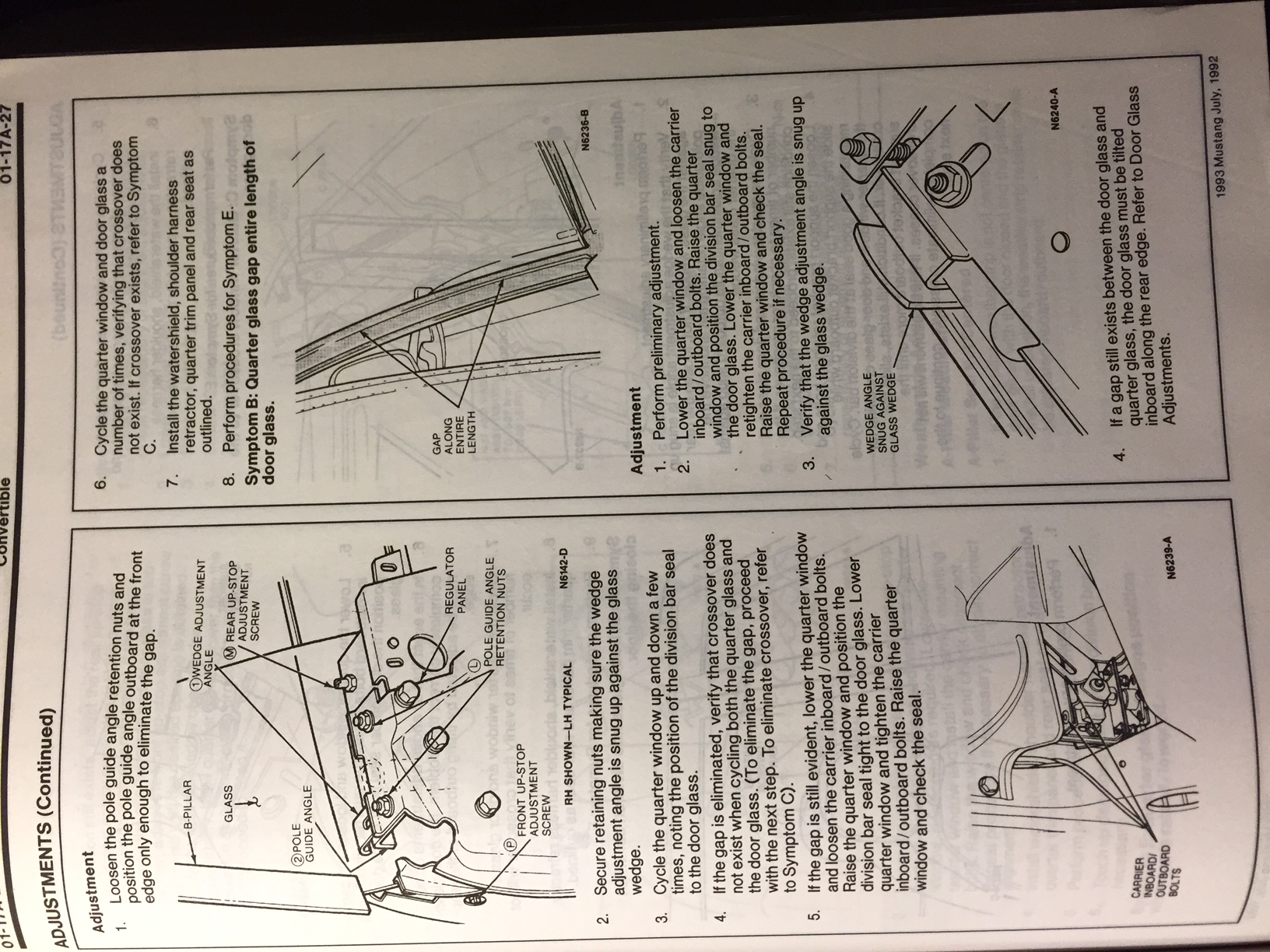

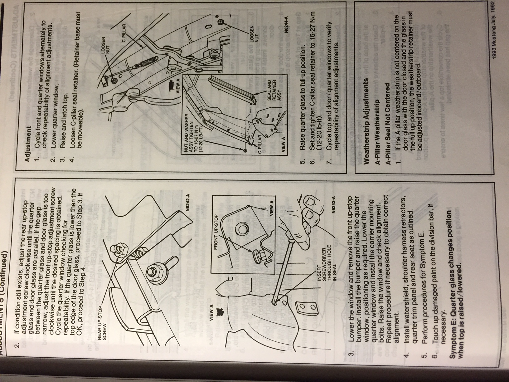

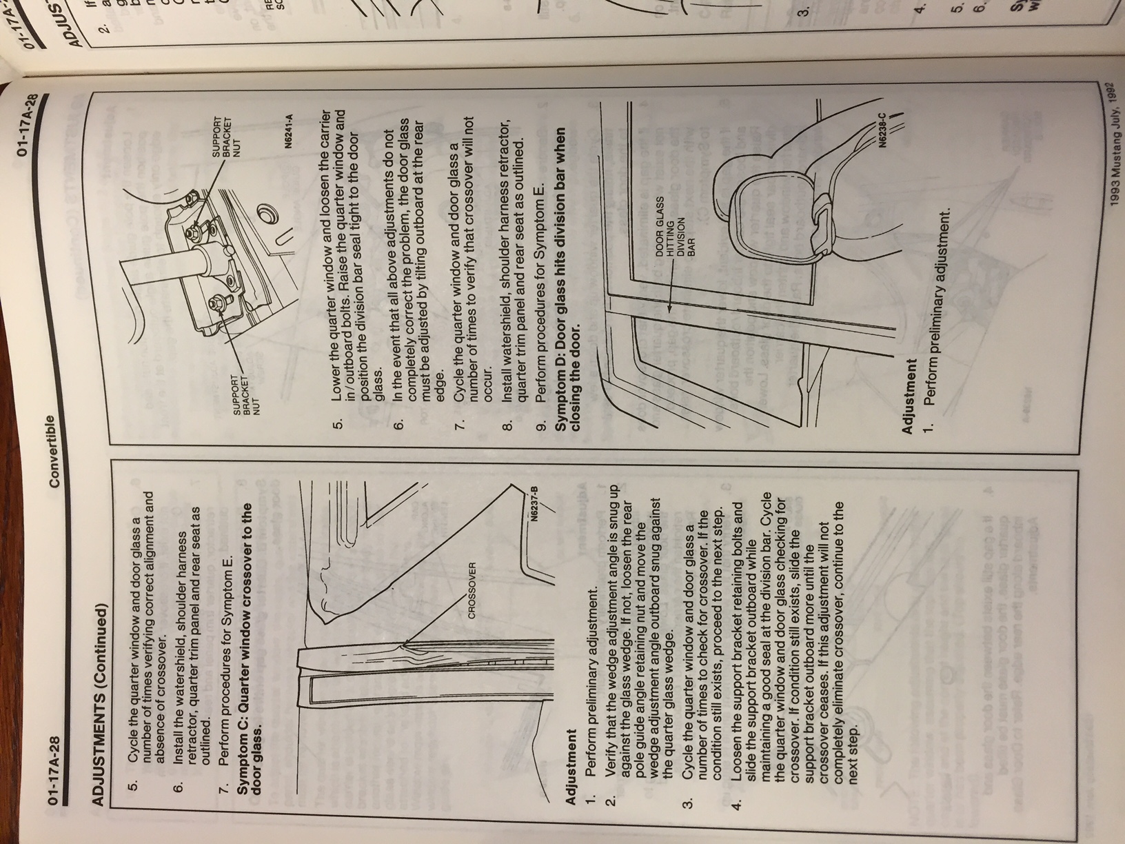

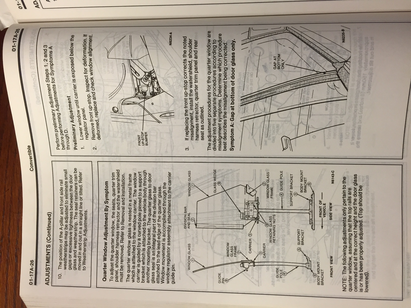

Anyone know what all the adjustment screws on the rear 1/4 windows do? I know there are 6: 2 on the guide rod mount, 2 on the top of the window carrier and 2 on the bottom of the window carrier.
I need to more the window back a bit to get a better gap between the door window and the 1/4 windows. Right now after changing my guide rod mounts the door glass an the 1/4 glass are touching. I need to move the 1/4 windows back about .25 inch to get the proper gap.
