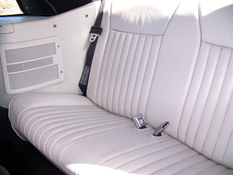

    That being said, it is possible to correct for this and/or find replacement parts of a different color and color-match. A friend of the site, Ron E., emailed me with the following upon seeing this question. He has had excellent results with his interior.
    "I had a pint of vinyl paint* custom matched to the interior of my triplewhite which is also the same Oxford White used in 92 and then put into spray cans.
    I removed the speaker grilles and the speakers to paint them and wiped them prior to painting with acetone (?). The paint store told me what to use. I also did the seat belt bezel above the speaker grilles and the armrest bolt hole covers. I masked the bezels as its a job to remove them as the quarter panel trim has to come out and there is a danger you will break them. You will also need to mask the seat belt off to avoid overspray on it.
    *for using on vinyl the auto body supply shop added some kind of additive or changed the mixture. I had the cars for 6 years and 8 years where they sat out with no problems such as flaking or peeling. The can says Omni-Pak Enamel Blend with color SEM or SEMP 5107. I actually have one full can left over and I used one can to do both cars. I would be willing to sell the can but not sure if it can be shipped."
