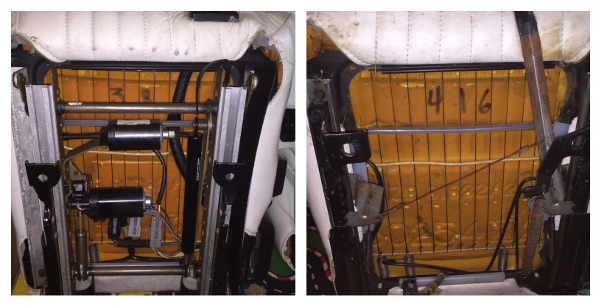

PSA: I've been trying a new thing with posts that I make to the main page. I also make them here in the forums in order to continue the discussion. If you are not in the habit of checking the main page at triplewhitefox.com and instead come directly to the forums you may want to check the main page once in a while or even convert to using that as your entry point.My winter project is centered around seats. I have a few minor issues to take care of. Right now the driver's seat is out of my car. I'm swapping out the power seat switch and possibly going to tackle debugging a slowly leaking lumbar support. I have a second seat that I am using for reference and parts. While having the two side-by-side on the bench I noticed something. There are numbers marked on the bottom. In the picture below, my seat is on the left and has "3 8". My spare has "4 16". With my car being built on 3/10/1993 I think that the "3 8" could be a date. This might be widely known but I didn't know I'd find this.
