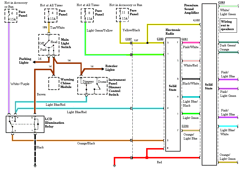

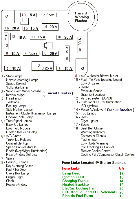

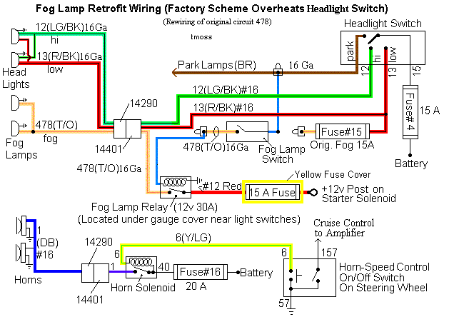

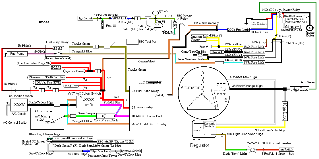

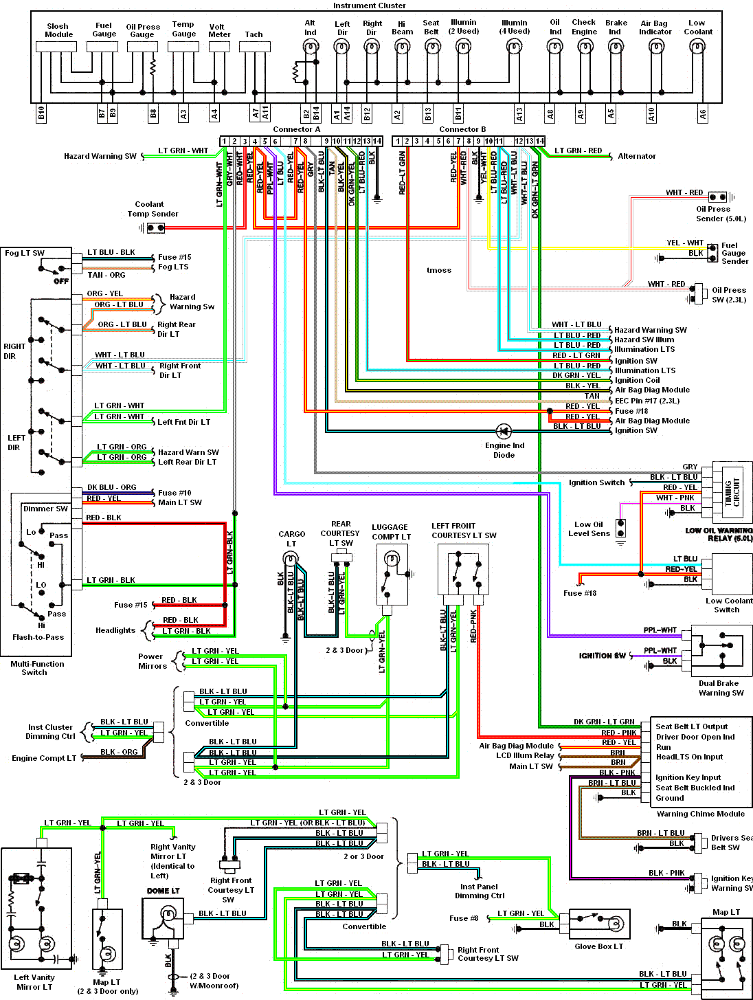

These should get me started. I will keep an eye out for a Ford manual on ebay.
Thanks again for the diagrams.
